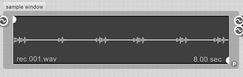

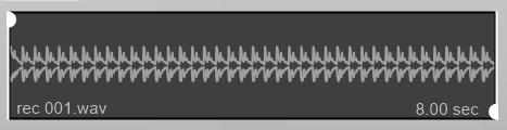

Here is the null->
original->
Nowhk
Posts: 275
Re: how to send Midi Message
Post by Nowhk »
nix wrote:Here is the null->
Thats not null :shock: Theres a problem... isn't?
Can you post please to me that module to check "null"? So I wont use FL for tests...

Yeah- something's up, it is very close though and almost cyclical
Nowhk
Posts: 275
Post by Nowhk »
I'll check it out, thanks.
Yes its cyclical, but for "Session". I mean, those shot are recorded in parallel. If I record other 2 rec, the cyclical is again, but on different point.
Its a "random cyclical".
Even if its close, under heavy distortion plugin that could make huge differences...
