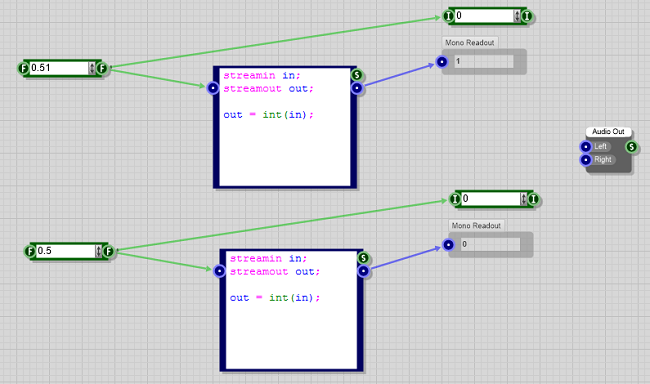

Here is a demo screen in stream:-
http://imageshack.com/a/img905/9174/tEtVTU.png
So .6 becomes one in a mono stream integer
Floats are usually used for constants in a stream,
but if you change the float value, the stream will update on next sample
Note the number of zeros, I used 441,000 samples
8D Enjoy and every success- pleased to help!

nix wrote:So .6 becomes one in a mono stream integer
I see. So the built-in Int module already does this round. This explain why 0.51 (and not 0.50) read new sample:
approximation fault :!: All is very more clear!!!

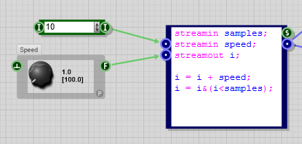

Oh nice, now I got it! You put x10 as max limit, and divided by 44100 (so each 1 second). Nice, but I'd prefer somethings like this:
and change speed with a knob ;) Since this won't impact on the sync if I don't move it, its fast to adjust values with GUI.

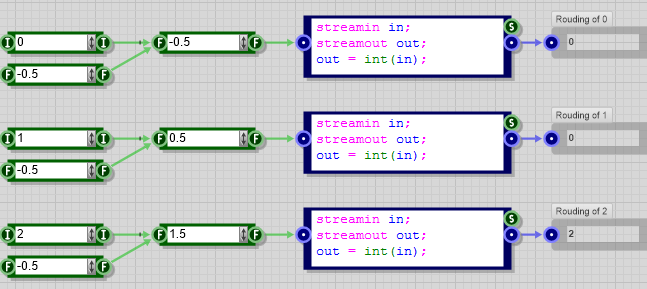

Also, that "-0.5" trick works for float value. If I use integer step, this will fails.
For example:
0 become -0.5, which is 0
1 become 0.5, which is 0 (1 is at 0.51)
2 become 1.50, which is 2
so I'll miss the sample at index 1:
That's a problem!!!
Is there a way on low level language to do a round-down integer rounding?

I guess there was a bug in the "int" function causing "int" to round up. I just tested it with the current Beta version (= new DSP/ASM) and it's fixed there.

MyCo wrote:I guess there was a bug in the "int" function causing "int" to round up. I just tested it with the current Beta version (= new DSP/ASM) and it's fixed there.
I can't use the new Beta Version, since I'm using FlowStone inside FL Studio, and at the moment I don't know if it will be supported there.
Are you saying that .5 now will always round up to 1 and not 0? Because also 2.5 round to 2 instead of 3. The same for any odd values. i.e. 1,3,5,7 (-0.5 each) rounds to 0 2 4 6 instead of 1,3,5,7...

no, "int" always rounds down now. For bi-directional rounding you should use "rndint"

MyCo wrote:no, "int" always rounds down now. For bi-directional rounding you should use "rndint"
This will be perfect! I won't need the "-0.5" trick anymore.
It might works for any value (integer and float) for my intent...
