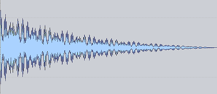

I have a problem to solve. If I have a beating sound, made of 2-4 FFT (sine like) components (= slightly irregular envelope, beating speeds unknown) that fades out (not linearly) - I'd like to draw (measure) a curve that follows peak (or average? or peak?) values of that fade out.
Sometimes the beating sound may be made of 2 FFT components, producing 0.2Hz beating. So - how to approach it, to get theoretical curve points in selected points of time? Some sort of envelope follower? Some sort of FFT band recalculation at some sort of resolution?

The easiest would be to take an envelope follower with a decay time long enough to average out the beating but short enough to follow the fade-out of the sound. (In your graph the beating appears to be much quicker than the fade-out.)

That was an example.
I'm trying to make some sort of analyzer for an instrument (singing bowl).
Basically, the instrument's output is/should be split into multiple, narrow FFT bands (few up to 16). I'm not sure if this can be doable correctly in FS due to lack of resolution (vs performance), but band features can be provided externally from other app, where measurements are made at 128-512kpts (measurements for different purposes).
Anyway, after the sound is split into bands, each band contains 1-4 sine like stable peaks (constant frequency). Now - if some of these peaks are very close, it produces very slow beating, like 1 to even 5 seconds per cycle. But peaks can be far enough from each other and in bi-pair configurations - envelope is more "stable" so to speak.
Now the tricky part. The instrument's fade out speeds (per band) depend on environmental factors, and of course they differ from instrument to instrument. So what I'd like to measure - are time points (like 0.3, 4, 8, 12, 16s) for each band, and use it as a starting point for further work. But. If I use envelope - then at slow beats I would rather need to "reconstruct" the theoretical envelope according to peaking of the beat. If I use FFT sub-arrays (per band) - I could probably (at least this is how I undetrstand it) determine/predict the peak amplitude for selected time points. So I came to conclusion, that maybe a way would be to use FFT data per band to calculate/predict the wave theoretical max peak value at time points? Sort of.

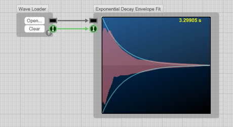

You might try to model your signal as exponentially decaying and fit the time constant. Here is a schematic that may serve as a start. I adopted KG's idea of analyzing the wave file in reverse order, searching for peaks which are greater than previous peaks. The resulting set of data points is used for a linear regression to determine the best exponential envelope fit. Hope it helps.

Re: spectral vs time domain.
Thanks, I will play with it.
These are kind of sounds I deal with (see attachement). Sometimes band1 is most audible, but not always, so this is just an example. What usually happens - is the change in decay per band, and this is more interesting.
Theoretically, decay is indeed some sort of exponential fade out, I just didn't know how to approach it due to multi-peak structure.
