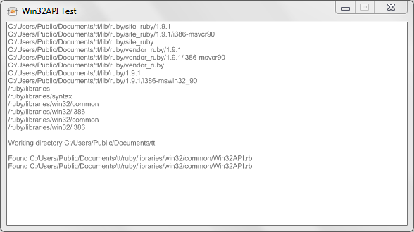

Re: Win32API bug
Win 7 no 'require SUCCESS' message
sorry
sorry

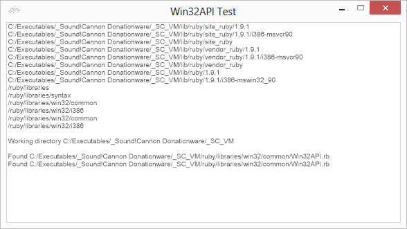

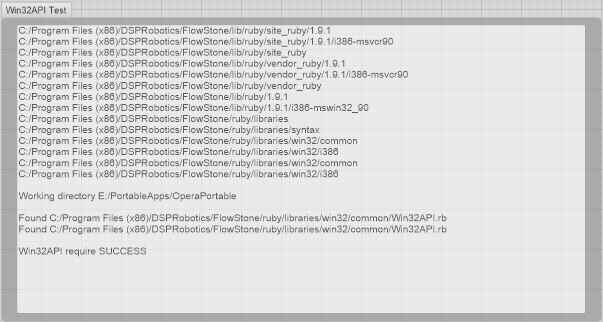

- Walter Sommerfeld
- Posts: 250
- Contact:
Re: Win32API bug
Hi Trog!
My System:
Win8 64 bit Quad Core
with Admin rights
cheers,
Walter
My System:
with Admin rights
cheers,
Walter
- win32API Test_in FS.png (53.92 KiB) Viewed 21699 times
- Win32API Test.png (28.92 KiB) Viewed 21699 times
- trogluddite
- Posts: 1730
Re: Win32API bug
Brilliant - thanks Walter.
That pretty much wraps it up then - definitely something in Flowstone.
Looking at the reports, I also notice something else...
The User guide states that you must copy the 'ruby' folder OR have FS installed on the machine. However, no-ones $LOAD_PATH includes the 'win32/common' folder from Program Files - just a duplicate of the working directory relative path. This is why I explicitly asked for folks to copy the folder - were the user guide and $LOAD_PATH correct, this shouldn't be necessary for any of us. Seems that this is "universal" to all installations as well.
Time to mail Malc again!
Re: Win32API bug
Failing on Windows 8 here, too.
However I think it tries to load the lib, when you copy the ruby folder to the root of your EXE filesystem. eg. when the EXE is on drive C, copy the ruby folder to C:/ruby. Problem there is quite bad, though. It crashs the EXE instantly.
