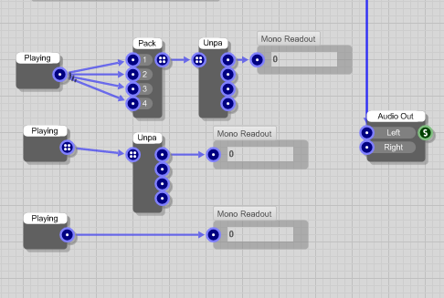

In the meantime, here's a way of working around it that might help...
I'm testing in FL....
Nothing works in this pic....
Then, for some reason, just drop this into schematic..
And everything works.... :? :?
give it a try with your fsm...weird... :?

I didnt clarify this...but dont connect the green/ruby
prim...just drop it into schematic un-connected..
and still use the blue.
