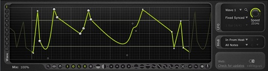

Post by Father »
I was looking at both forums and couldn't find anything...
Is there a volume envelope/shaper like this around? Or should we start from scratch?
http://www.cableguys.de/volume-shaper.html

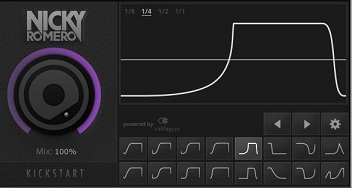

I see. Doesn't have to be so advanced I think something basic will do, like this Kickstart thingy:
But with editable shape. I wanted to see what has been done, before jumping into it and inventing a broken wheel! hehe
