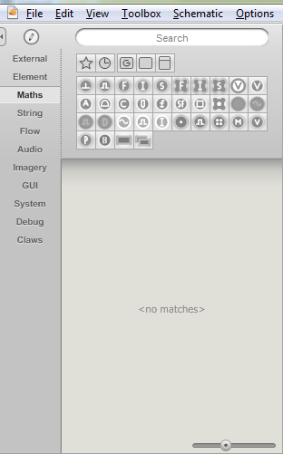

Hello,
In my overview the tag filters are emtpy.
how can i reset it?
how can i reset it?
- tags
- tags.png (22.03 KiB) Viewed 12395 times

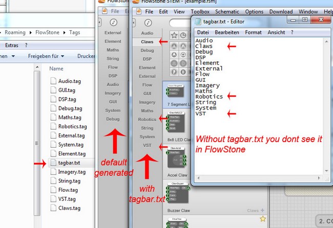

i have writen a little cmd batch tool.
this will generate the tagbar.txt which would not generated automatical.
the problem:
some times FlowStone lost the information for the given tags in the AppData\Roaming\FlowStone\Tags folder.
If you delete the Tags folder, FlowStone create it automatical after open and close of FlowStone.
But it does not generate the tagbar.txt file which is needet for displaying it in FlowStone.
If you create new Tags you have to save the configuration before deleting the Tags folder.
In my example its the Claw.tag
So save the claw.tag
delete the tag folder
start FlowStone and close it
Now copy the saved tags back to the Tag directory
After this you have to start the tag-create.bat file.
This will generate the tagbar.txt in the tag folder.
After starting flow stone you will now see all availible tags
As you see the tags now sorted alphabetical

Re: Basic Tags are empty
Hi SonicBe@m,
nice idea but some warning and a little hint from me:
1. If the tag has a space in it's name... only 1st part is listed but wo anything in it...
2. normally all tags are regenerated after restart...
3. some quick .bat changes:
Echo off
cls
REM tag-create generates a new tagbar.txt file with the given tag files in the tag directory
REM this is usefully if you have own created tags and or plugins installen and are not listed in FlowStone
REM set the tags path
Set tagspath="C:\Users\%USERNAME%\AppData\Roaming\FlowStone\Tags\"
REM go to tags path
cd %tagspath%
REM remove old tagbar txt
del tagbar.txt
REM create new tagbar.txt with the given tags inside the folder (eg. FlowStone\Tags)
@for /f "delims=" %%i in ('dir /b /a:-d *.tag') do @echo %%~ni>>tagbar.txt
REM "delims=" This override the default delimiters which are TAB and SPACE so it
REM works for loop with spaces in dir/file name(s)
REM the new tagbar.txt lists all entrys from the tags folder
Echo done
