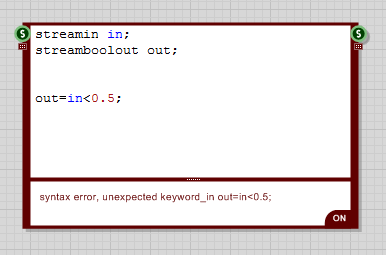

God, you are fast enough :) What should I need to do with that code? Insert on a ruby script?
Seems an error, but maybe I totally misunderstand. I'm a novice :lol:

Use DSP code component

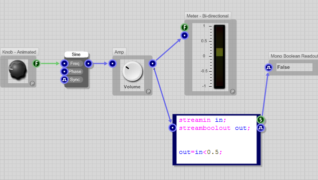

Ok. Now I got this situation for testing this:
Not sure I'm doing it right :) I don't see any Green :geek:

You don't want to perform the operation on the audio signal itself but rather on the envelope (which is basically a rectified and then lowpassed audio signal). Fortunately there is a stock envelope follower module in the toolbox which you can simply place between the volume knob and the code box in your schematic above.

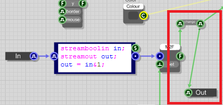

KG_is_back wrote:Double click the mono boolean module. Inside you will see how streams are converted to boolean. Add one output prim and connect it there.
In this way?
I see the Boolean in the output of Mono Boolean module, but it doesn't works: it doesn't trigger any bool with your method.
