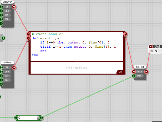

Well, this is what I've done with Ruby:
not sure how much consistency this code will be, but seems to works.
How is managed the output time and @ins array? Are unique for each event handler? Or can they mess each others?

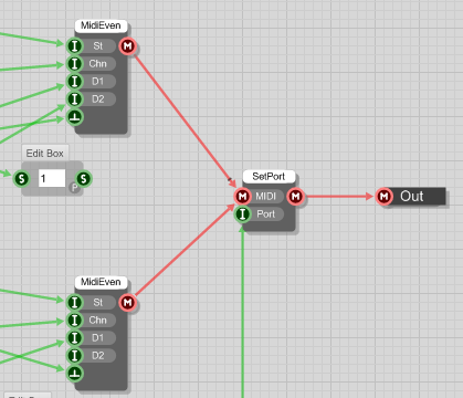

tiffy wrote:Did you try to change the "link Order" of the two Midi Inputs on the "setPort" primitive?
Uhm, how can I do it? Order on the links? :shock:

Post by Nowhk »

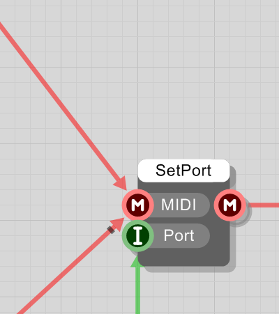

tiffy wrote:The easiest is to connect the top link first and then the bottom link or alternatively hover mouse on the left side "M" of the setPort primitive and left click on it once only. You will see the marker flip to the lower Midi link.
In this way?
Nothing change. The upper part is trigger later :roll:

tiffy wrote:Yes.
I want the upper part triggered before :) And also if I switch the cables, nothing change: the lower part always output as first.

Any Flowstone/DSP master can tell me if my Ruby approch is ok? I don't know in deep how pins/events/time/arrays are processed, honestly.

In the code you have written,
it doesn't actually delay the second one I think.
It allows the signal to pass through without change.

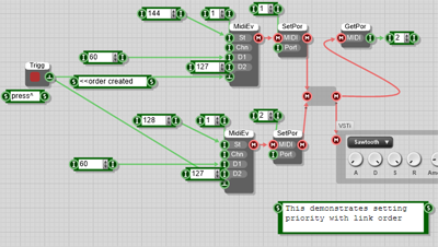

Tiffy is quite right that we can use a trick here if you are happy to create the message with the 'midi event'
prims. You can do this link order thing with trigger input pins of the 'MIDI event'.

Here is a demo of the link order setting priority->
link order.png (75.71 KiB) Viewed 19665 times
4Nowhk_link order.fsm
(22.41 KiB) Downloaded 917 times
The links out of the button set the order.
