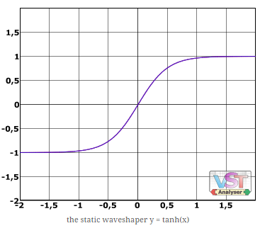

"Distortion" can mean a lot of things, but most commonly its basis is in waveshaping. And waveshaping is simply math functions applied to the input signal that alters the output signal.
For example (grabbed this from Variety of Sound)
This is a simple "saturation"-type waveshaping that mimics the saturation distortion in an analog system.
There are many ways to spice things up with filtering and well whatever you could imagine.
There is a basic waveshaping module in the stock toolbox.
