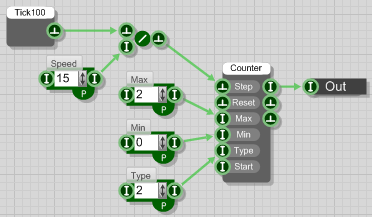

This one is very simple. No Poly to Mono, and it still crashes :? I replaced the Asio Out with Direct Sound but still i can make it crash.
Crash.fsm
Very simple crashing schem
(1.72 KiB) Downloaded 1091 times
