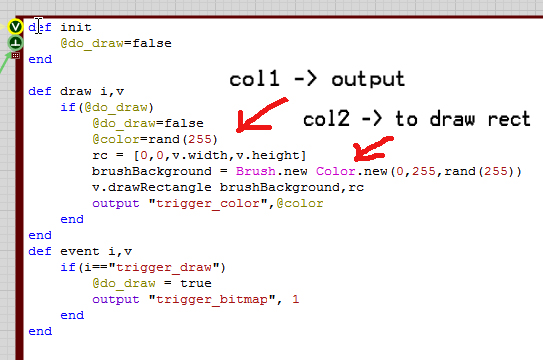

They are not 2 different colorsNubeat7 wrote:sure, when you are using 2 different random colors, they will not be the same...Nowhk wrote: When you trigger, the color in the "current background" must be the same of the one in the generated "Bitmap", but that's not always true (or maybe: its rare that the two are the same).

2 colors! still don't understand what you exactly want to achieve, if you want that other people fix your problems you will need to share them...Nowhk wrote: They are not 2 different colorsI choose one (random), I draw the V and I send the color as output (to monitor it). The color is one.
