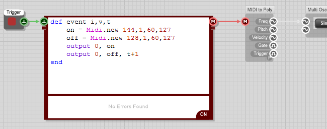

I've just see you had posted this message time ago, Tronic: "and then writes and reads continuously from memory"
It seems that outputs (the bridge between Ruby back to FlowStone) could run at different times from which they are called. If this is true, how can (for example) MIDI be sync internally of FlowStone when I create/manage/trigger them with Ruby (that is 100Hz accurate)?
I mean: if I generate a MIDI message and I stop it after 1 second:
Ruby MIDI Note On-Off.fsm
(8.01 KiB) Downloaded 970 times
who can guaranteed to me that it play exactly at time t and ends at time t+1? Ruby events are sync/scheduled to run at those fixed times, yes, but later MIDI will takes time to process/output to the following step (i.e. from my code to the input of Osc).
I know that every sample of type stream happen at correct timing, because FlowStone take care of this (following my not-proof idea about how FlowStone audio works); I think in the usual way of doing DSP using buffers: process data, create frames of samples and send them to ASIO (or trasmitted to the DAW that will treat them), but is this really true also with MIDI?

However, as the manual says when a primitive external Audio is on,
it is synchronized and processed with the same sample rate,
but from my test I have determined that it is processed with an identical frequency,
but equal to the size of the audio buffer.
If the trigger is generated by a green, is not as much as it is ensured that the "t + 1", actually ends at "t + 1",
but we must think, when exactly the green will run?
And that is where the synchronization fails,
And in any case the "t + 1" is guaranteed.
Then also consider this:
In my opinion, from c++ side,
the Midi Queue Buffer does not run in the same thread-function of the audio,
so does not guarantee synchronized performance of it.

Tronic wrote:If the trigger is generated by a green, is not as much as it is ensured that the "t + 1", actually ends at "t + 1"
Ok sorry, I've wrong init point. Let says that the trigger is generated by a Frame (from mono to frame prim), at a fixed speed by DSP code (audio): Ruby events runs exactly sync with it (I trust this).
But what about MIDI (i.e. the part I'm interessed)? That's the point. I don't care if Ruby event execute in time, I care that what I create inside this task is executed in time :D
Once Ruby event run, to generate, manipulate and than send my new MIDI to the output (and than processed back to FlowStone/C++ again) it will requires overhead. Is it included in the Ruby/event time syncing this? :o
Tronic wrote: Then also consider this:
Is it normal that inside an audio development environment, MIDI (which is fondamental in audio) could be not sync? I don't believe in this... I think I'm missing somethings...

I think there's a general misunderstanding. In germany we say: "Zäum das Pferd nicht von hinten auf." A look at dict.cc tells me that the english equivalent is "Don't put the cart before the horse".
Flowstone's task is to sit as a slave in a DAW and react to everything the DAW requires it to do. And that's exactly what it does.
A midi signal comes in from the DAW, Flowstone sends audio out.
A midi signal comes from the DAW, Flowstones sends the changed midi signal out.
An audio signal comes from the DAW, Flowstone sends the changed audio signal out.
With delay compensation, everything is exactly on point. Does MIDI need to be sample-precise in sync? Not at all! Under circumstances it even can't be! MIDI precision is defined by ppq. While modern DAWs work with 960 and more, older ones and FL Studio only work with 96 ppq. But that doesn't matter much. The output of Flowstone is buffered, which means, everything will be on point at that moment, even with low ppq. Only if your task exceeds the time the buffer is played, you will get in timing trouble. The result is stutter, clicks, noise and such. As long as the output sounds great, everything is right on time.
But reading what you are complaining about let's me assume you don't want to create a plugin, but a host. Because only a host needs to be perfect in midi timing to be able to control the flow of things. And Flowstone was never build to create a host with it. Nor will it ever.
