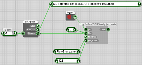

Back to an issue I'm having
It seems FS RUBY does not have the FileUtils class.
What I'm trying to do is:
1. Copy a file to a new dest folder ... then,
2. Re-name the new [copied] file.
3. Insuring that the original file remains intact at original location.
I've used the posted 'File.rename(@old_name, @new_name)' , but it is removing the original file
Note: The goal. I have to make copies of a single file and rename them as new files in a new folder. There could be a dozen or more copies]. I'm using a filename list to increment through in the rename process.
Note 2. I also tried the EXEC primitive to do the copy. I can't seem to get that to work.
I suck

Re: File Handling
Hi,
here a method 4U i got from DWB (hope he don't mind)
Keep on Doing!
Walter
def copy_file(src,dest)
File.open(src, 'rb') do |s|
File.open(dest, 'wb', s.stat.mode) do |f|
IO.copy_stream(s, f)
end
end
endWalter
Re: File Handling
Thanks Walter [....and DWB]
I'll give this a go when I get back.
Appreciate.
Appreciate.
Re: File Handling
hmmm ... no luck getting this code working ... as yet.

Re: File Handling
Here u go...
Have Phun
Warning: Dest will be overwritten and path must exist...
Have Phun
- ...I think U need Admin rights because of ProgFiles path 4 this test schematic:
- copy file fom DWB in ruby (sun mod).png (288.42 KiB) Viewed 22861 times
- copy file fom DWB in ruby (sun mod).fsm
- (1.31 KiB) Downloaded 922 times
