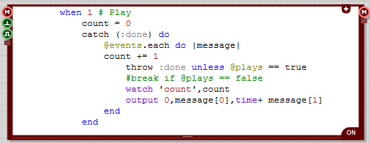

Well - now always these little problems...
I cannot exit this each do loop
It always run's until it's end.
The count shows immediately the max events.length!
It doesn't matter whether i use catch/throw or break...
Is there a trick with raising an error or something else?!
- throw or break doesn't work here.png (330.85 KiB) Viewed 22790 times
Re: how to send Midi Message
I'm not 100% sure, but here are some thoughts:
(1) break would have been sufficient. That both don't work, seems to point to '@plays' being the cause.
(2) each is a closed loop. It will be executed exactly at the time it is called. There is no connection to the external world (which means everything outside of 'when 1')
(3) if @plays happens to be an input, then .each will not be aware of any changes to the input until .each is done and Ruby is given a chance to peek at the inputs again.
(4) In case (3) is true, you need another way to loop through (for example scheduled inputs/methods), so that @plays is checked for its current state in each iteration.
scheduled inputs/methods => Ahh - i see... had this in an older project - will try my best here...(3) if @plays happens to be an input, then .each will not be aware of any changes to the input until .each is done and Ruby is given a chance to peek at the inputs again.
Thanks 4 the hint!
Scheduling a method is straight forward. For this example, create a boolean input for your RubyEdit and link it with a boolean prim set to false. Then paste the following code:
Now switch the boolean prim to true and wait two seconds. As you can see, the event occured right on time, but the method is executed 2 seconds later (t + 2).
For your task I would go with scheduled inputs. I've attached an example.
Thanks again Tom - will be a long night
Hope i get no Midi Timing probs...
Keep on Doing!
=> Short Report...
Got it now
But this idea of breaking into the playing loop is really bad...
How could i know when to stop and which notes Off 2 send?!
Could do this with an array and send the corresponding ones...
a way to heavy task now - only wanted a quick record looper
for some controller CC's/Notes => this works perfectly, so - I've done it!
Keep on Doing!
=> Short Report...
Got it now
This almost escaped my notice. A new post is better if more than a few hours movedWalter Sommerfeld wrote: => Short Report...
Got it now
Yes, you're right. It's as always, as soon as you try to take over control against the DAW, you'll be in trouble.
But I'm glad that the original idea works. Good job!
