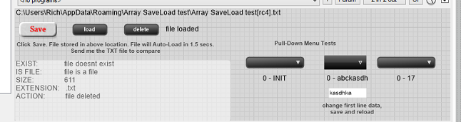

OK ... we got pics !!! :lol:
From the 4a test module, my beta-tester sent these Screenshots.
When the test VST is first loaded, this is what's seen:
first load.png (46.42 KiB) Viewed 23164 times

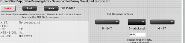

When the SAVE button is clicked ... he sees this result.
type and save.png (42.09 KiB) Viewed 23164 times
The file is not happening.
After he has tried several times ... it will start to work, and the Saved file will load and populate the menus.
