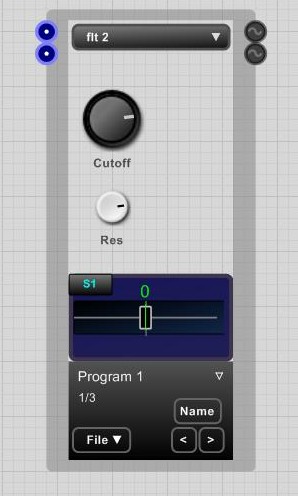

hmmm ... I'm stuck .... trying to adapt the NuBeat, 'multi-function' sliders into this new multi-GUI design logic. :roll:
I've gone back to the basic example that was posted in order to simplify the troubleshoot and implementation.
Here's the example screen shot
The slider is a dual function one that uses the same slider with a button selector to choose S1 or S2 [or more].
The main PreSetManager captures all the preset settings, and already works, using NuBeats special 'preset' module.
What I'm trying to do ...
At the fop of the schematic is a 'FLT' menu, that dynamically switches the GUI and values. The complication is how to tie the multi-slider into this design that would maintain both values in each selected 'FLT' independently. In other words, just as the knobs retain their value, so must the multi-slider.
Trying to figure out the logic of this :|
All my attempts have failed ... so this is why I post the most simple example.
Here's the schematic .... hope someone can figure how to do this :oops:
presetarray_example [NuBeat] [RJH-Mod]-2b.fsm
(38.84 KiB) Downloaded 1093 times

well .... I kinda got something working .... but, boy ... it seems a lame solution .... even for me :o
I switched out the select button with another that was easier to modify [its amazing how many different button designs [internal] there are [from various SM/FS posts].
As to the dual-function sliders ... the 'lame' solution was monitoring 2 'indexes' .... 1 for the button, which has 2 states [0,1] ... and then the 5 positions of the main INDEX.
The NuBeat preset module was assigned 10 entries .... I'm still not sure what to do with the preset 'names', if I should use a string name with an added index number !??!
On the main INDEX, I fed that to a SELECTOR PRIM, and used INT strings for each choice [0,2,4,6,8].
On the SELECTOR output, I fed an ADD prim to combine values of the button index and the main index ... this then was fed to the preset 'select' input.
Monitoring the array output, I can see each array being addressed .... but this is really a rookie looking solution it seems :oops:
Also ... still not sure how to NAME the presets. Should I use a index number suffix to a function name ? or just a name ... i don't know yet.
Anyway ... just trying an idea that's starting to work .... but really hope for a better way. :roll:

RJHollins wrote:I'm still not sure what to do with the preset 'names', if I should use a string name with an added index number !??
each preset array prim can only have one unique name and gets numbered with the indexes automatically like :
presetname 1
presetname 2
presetname 3
what you try to do is a nested preset array - i think your solution is pretty smart - but you need to live with the same presetname and if you want to automate it, parameters will be shown in daw as above,
not sure what this switch is used for? it is meant as switching between 2 snapshots of one parameter or?

ahh ... OK on the preset names. The more I thought about, it does make better sense.
The button that switches the 'dual-fader'. The function I had in mind was to use this as a [CC] Continuous Controller that could be alternated between 2 different controllers. [or as you originally designed, as many controllers as needed]. This was to maximize use of GUI space. I have been using this idea, and it works great.
The way I have it in my 'complex' schematic is having BOTH values displayed, so that the numerics are always visible. The button switches to activate the desired [CC}. The 'hidden' value is displayed too. What is really nice about this ... when the button switches, the slider SNAPS to the correct value.
I'm going to go back and check my preset naming. I think I had over-complicated that by tagging the index number onto the name, sending that to your preset module. I think that was working with the knob and pull-down elements ... but now seems I did this wrong [or at least, over did it] :lol:
mmm ... nested arrays. I need to think about that idea. I think I just stumbled onto that [not realizing], but I did get it to work .
