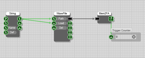

This will also introduce another problem: when you change the sample as VST.
Let say you load SampleA and save the schematic, than export as VST.
When you load, it first will load the wave inside the schematic, and that's ok. If now I change the sample (SampleB) and I store the path to the preset (for reload it next loading), when I reload it will load first the wave inside the schematic, than the sample stored in preset:
If you look at Trigger counter when you load the VST first time (no data in preset), you will see count 1 (the wave stored on schematic when you export as VST).
If you now change the sample (which will store the path to Preset String), save the preset and reload, count is 2 (it first load schematic one, than from VST).
Two times! And this makes trouble, since there are two scenario, where in one you don't have informations about channels, and one with trigger twice and send wave + n of channels.
Is it clear what I mean?

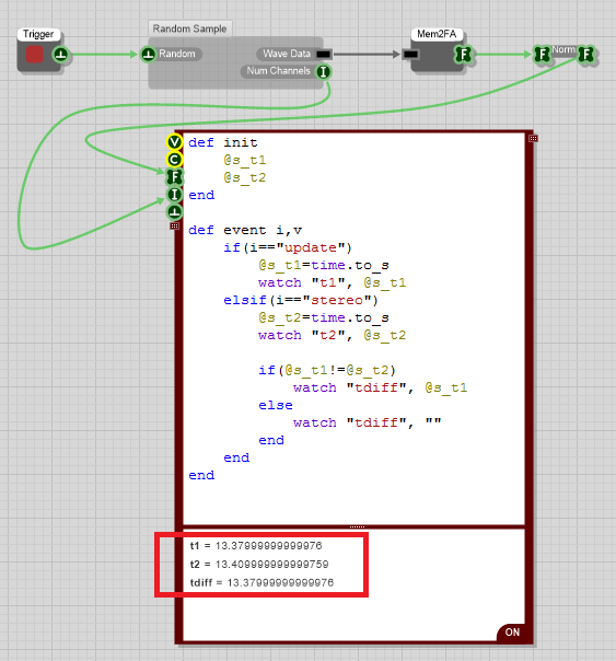

Uhm... I don't understand why you get "update" and "stereo" trigger at the same time:
when :update
	getCoordinates
	redraw 0
	watch "t1", time
when :stereo
	watch "t2", time
it prints the same time! In my example instead, update is triggered (sometimes) before stereo, and this is a huge problem, since the "update trigger" will create data to draw where the number of channels is missing.
This is the way I process it:
why this happens "sometimes"? Try clicking on the Trigger many times (10/20 times): at some points you will see the value of tdiff with the value, and if you looks at the times, they are different (looks at the pic). I don't know where the issue born...
Maybe it process "[F]" (update) at different ticks of I (stereo) in Ruby's event stack? So that difference in time? How can I fix this? Double flag?
test.fsm
(1018.49 KiB) Downloaded 1020 times
(note you need to put some samples path inside the array to switch random to them and looks at the results. Try with samples with huge size for better results)

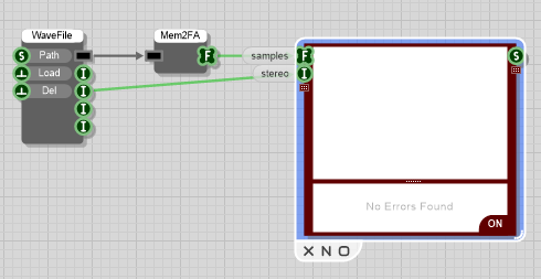

there are two ways to fix this, program the wavedrawer in a way where it doesn't matter what the stereo flag says, or if you are sure that it is a timing thing you can sample and hold the wave and give it free after the channels are setted
so the first connection of the channels output goes to your ruby wavedrawer and the second triggers the sample and hold to send the wavefile to the wavedrawer...
Nowhk
Posts: 275
Post by Nowhk »
Nubeat7 wrote:there are two ways to fix this, program the wavedrawer in a way where it doesn't matter what the stereo flag says
:shock: How do you decide if the wave is stereo or mono without this info?
Nubeat7 wrote:so the first connection of the channels output goes to your ruby wavedrawer and the second triggers the sample and hold to send the wavefile to the wavedrawer...
Sure :) But as I said before, this only happens when I load a sample from Wave Loader. Instead, when I just load the schematic, the "stereo" field won't be triggered to Ruby (it just read/refresh value on the connector->@stereo; no trigger happens). That's the problem...
Also, it's strange enough that Mem (which takes couble of ms to read/send [F] to Ruby) happens at the same time of Number of Channels trigger (when they happens together). Or is it the time Ruby will read from connector at fixed tick?
I thought that once Ruby reach a trigger, it just process the event one after one. But it seems it stacks them and process at fixed tick (I guess; it is not written in manual, I don't find this information).
