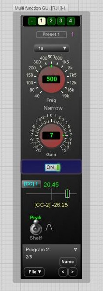

OK ... I've got some of the basics assembled for a GUI display that can be changed dynamically. :shock:
Instead of using video switching [much like multi-tabbed windows], I've tried to focus on using things like VECTOR knobs that can be re-configured.
The basis of the idea [which mirrors of type of EQ], is having a main GUI window that has EMPTY slots. Within each 'slot', a module can be assigned. Each module has a 'radio button' switcher that directs the configuration.
What I'm showing is just one module example.
The basic look is something like this:
I'm just getting some of the often used control objects pre-assembled in order to troubleshoot and finetune the design and flow.
There are some important design goals that I'm looking toward, such as, radio-switching between available choices should each retain their last setting. Globally, the main PresetManager should capture and restore everything. The actually number of GUI modules could be anything from 1 to a dozen [or more I suppose]. That would depend on the size of each module, and would be restricted by the overall size of the main GUI window [VST].
I'm still early in putting this together, and there are still some outstanding issues that I'd like to fix ... but for those interested in helping troubleshoot and refine ... that would be most welcomed !!!
Some of the GURUs here might recognize some of their works contain within. I hesitate to mention names, because NO DOUBT, an important one [or three] would be left off :roll:
I must single out of of our Gurus .... that would be Mr.NuBeat . ;) Beside some wonderful designs and examples that he has shared ... he has also helped a 'newb' expand the thinking/design process.
The inspiration for this project stems from the 'dual-function' slider that NuBeat had posted awhile back.
I caution though .... it will be easy to see what my rookie work is like ... and this is with conscience effort to try and improve :shock: I've got much to learn, and a long ways to go .... but I sincerely appreciate the volumes of help I have received here and previously on the SM forum.
Thanks to everyone for any comments, suggestions, improvements and replacement coding. At this point, the module doesn't actually do anything ... but before it does, I would like to get a solid GUI core happening.
Here's my current schematic:
Multi function GUI [RJH]-1.fsm
(84.09 KiB) Downloaded 1108 times
Thanks GANG !
8-)

thx Rj for the kind of words,
nice clean schematic, what i could see is that you`ve still putted the selected module index to the end of the presetname, you shouldn`t do this (anyway the presetparameter array do the same automatically) it only can have one name other wise the DAW gets confused when loading parameters,
lets say the current index is 2 and you load a preset where it is 4 - it is looking for a presetparameter(array)name with 4 on the end but there is none because its set to 2 atm... its the same like with normal presets you need a unique name for the presetparameter prim to get found when loading presets
just try it in a daw and watch your automation parameters for your app (dont forget to turn auto on, it is not connected in my original module - so its set to off!)

Nubeat7 wrote:what i could see is that you`ve still putted the selected module index to the end of the presetname, you shouldn`t do this (anyway the presetparameter array do the same automatically) it only can have one name other wise the DAW gets confused when loading parameters,
Thanks NuBeat !
I pulled the INDEX suffix off all the sub modules, and while in there, added a TRUE link to the AUTO.
I'd had not tested yet in any DAW ... still working through much of the logic.
There is one function I still don't have working as I'd like .... that small ON/OFF button is tied into the GAIN control. What it is suppose to do is change the OUTPUT value to the gain's DEFAULT value ... while STILL holding the position of the needle on the gain knob. The numeric displays go the RED to indicate that this is in a soft bypass mode. The FREQ also turns red, but it is NOT set to default [this way we have a choice if this feature is needed or not]. I use this as a quick A/B comparison of the GAIN [+/-] that a band is given. This would allow auditioning that applied level. Even when the gain is 'bypassed', the level can still be adjusted [silently], and then when UN-bypassed, the NEW level is kicked out. I use this in my regular designs, but this new 'multi' approach is different. Hope I can fix this :roll:
Anyway ... thanks for catching my initial errors. Tomorrow I'll post up the changes.
