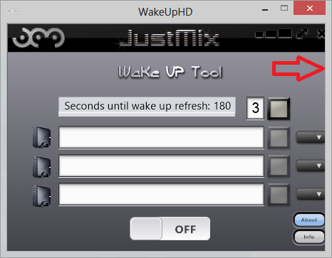

Ooops - overlooked this bug:
One grid is missing vertical on the right Border and horiz. at the bottom in Focus Mode and on the right in EXE's
FS v309b1 bug EXE R-1Grid.png (46.23 KiB) Viewed 26787 times
MyCo
Posts: 718
Contact:
Re: FlowStone 3.0.9 Beta1
Post by MyCo »
hehehe, funny thing... we noticed it too, and are already investigating
