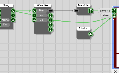

That's "so" dangerous. Let say you have 3 triggers that happens at the same time (1 from data on connectors stored in the schematic, 1 from Preset Manager and 1 from AfterLoad) that sends respectively "samples" and "stereo":
loading 1: 2000 samples, stereo 2
loading 2: 3000 samples, stereo 1
loading 3: 5000 samples, stereo 2
If two "samples" trigger are invoked before any "stereo trigger", there's a problem (since there is no order/stack, that could happens).
Or also if combination of triggers happens, such as it got "sample 2000" from loading 1 and "stereo 1" from loading 2.
Of course I need to rely on how code is executed. Or at least, know how it is executed, so I need to prevent/block previous triggers before send them to Ruby (in this case).

If this is my situation:
I can have some problem with that "double check" variable you suggested. When I load the VST, first things that happens is the Mem2F trigger Ruby and send the array (using Event Data) previously saved in the schematic (let say Sample A, stereo).
Than, FlowStone will trigger After Load OR Preset String (which contains the path of Sample B, mono) due to how it "feel" in that moment (unpredictable, can't rely on it). It can happens that samples from Preset String, its Number of channels and the trigger of AfterLoad is scheduled to Ruby at the same time.
And if the trigger of After Load is executed after have stored to @stereo the value 1 of Sample B and before change the actual samples of it, I can have a inconsistency (it will draw Sample A mono).

Let suppose I've Trigger T1 that execute prim P1, and it generated (as you stated) two new triggers (TA and TB).
TA trigger directly R1 (path 1), while TB trigger P2 that trigger (TC) P3, which ends to R2 (path 2):
		    P1(->TA)		         R1        #path 1
(->T1)
		    P2(->TB) 	P3(->TC)	R2        #path 2
If there is no scheduling, and another T2 trigger P1 while (for example) P2 is triggering P3, who can guarantee to me/you that the second execution of R1 (reached by second trigger T2) will be executed after the first execution of R2 (reached by the first trigger T1) if there aren't any kind of scheduling?
