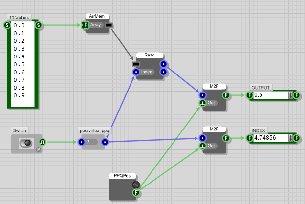

Run it at 10BPM for example:
schematic_bv_2.fsm
(4.61 KiB) Downloaded 1010 times
as you can see in the picture: INDEX it is not 5 yet, but it has already read the values from stream at index 5. They seems unrelated.
I guess index 0 is the first sample and index 44 is the 44° sample from stream? Or is here where am I wrong? Using fast speed you won't notice this, but in fact at slower speed its pretty clear.

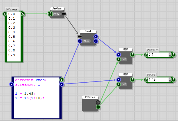

I think it's a floating point error. In fact, if I look at the Float outputted from DSP code:
i = i + 0.01;
i = i & (i < 10);
and catched by M2F, I get values such as this:
7.82008
5.39003
8.08009
since I increment it by 0.01, I can't have floats with 5 digit after the dot. What's happening on this increment?
So, I've place some fixed float value as i. And I've noticed that it reads the samples in a very "strange" way.
These are the results:
fixed i between [0.00, 0.50] => it reads Sample 1
fixed i between [0.51, 1.49] => it reads Sample 2
fixed i between [1.50, 2.50] => it reads Sample 3
for me those values makes no sense at all :o For example:
1 - why second value occurs after 0.50 instead of 1 at the beginning? (this is a huge problem, because it introduces an heavy offset).
2 - why the limits are sometimes 050, sometimes 0.49? (even if this is almost irrilevant; its only an approximation I guess).
How can I make this reading robust?

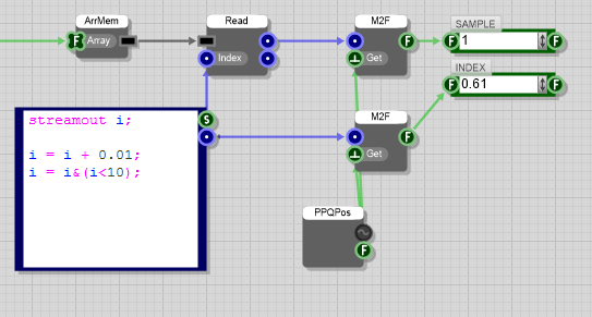

But as I stated above, using this process and the "READ" module seems to sucks. Also in your example this problem happens (using 0.01 instead of 1 as step):
You can see that index is 0.61, and it has already read the second sample (i.e. value 1).
That's because the second sample it's readed at 0.51 instead of 1.00 (0.50 of gap between first and second sample).
Than the gap between reading the next sample is 1, not 0.50 anymore.
I know this won't be a huge problem working on a wave with 1024 samples, but if I've these troubles at the beginning, they would become precarious.
I want to understand why it reads the samples in this way, for my future applications.
Is it a bug? Or is it a sort of math approx?
Because if it's correct, ok I can use it now and forever.
If it will change in the future, that's would be a problem. Any clues?

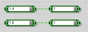

The .5 was needed because of the way the reader receives a stream integer,
even though it is just a blue mono dot. There are only polyint connector types.
The stream needs to be reduced by .5 because of a rounding error on the integer(whole number) conversion,
you know, like .6 rounds to 1, but .4 rounds to 0
So nice it's working now! You just need to be able to set bpm and be samplerate independent

nix wrote:The stream needs to be reduced by .5 because of a rounding error on the integer(whole number) conversion, you know, like .6 rounds to 1, but .4 rounds to 0
Not sure about what do you mean with rounding error. You mean that every float (from 1.0 to 1.99) must always round to 1 as integer? But seems that FS works already this way :shock:
