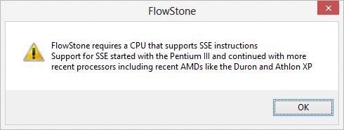

BUG: Touch-Screen R-Click simulation on EXE Compiled GUI and in FS... v309b1 disables this feature...
even wo new prim)
P.S.: 309b1 FSM's are not loadable in 3081Press and hold does the same thing as right-clicking an item. To perform the action, touch the screen where you want to right-click, hold until a box appears, and then lift your finger. The shortcut menu appears after you lift your finger.
- 309b1_vs_3081.jpg (14.33 KiB) Viewed 25600 times

I don't think FS can disable that in any way (as it just sees a right click). Else all I can say is that the right click behaviour wasn't changed at all in this version.Walter Sommerfeld wrote:BUG: Touch-Screen R-Click simulation on EXE Compiled GUI and in FS... v309b1 disables this feature...
Yes, forgot to mention. The saved files are not downward compatible due to the new assembler and the editor features (eg. bookmarks).Walter Sommerfeld wrote:P.S.: 309b1 FSM's are not loadable in 3081even wo new prim)

Update for that: It was caused by a library update. I think we fixed it... at least it's working on my old tablet again.MyCo wrote:I don't think FS can disable that in any way (as it just sees a right click). Else all I can say is that the right click behaviour wasn't changed at all in this version.Walter Sommerfeld wrote:BUG: Touch-Screen R-Click simulation on EXE Compiled GUI and in FS... v309b1 disables this feature...
