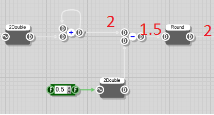

I can have part of y when it's exactly 0.5 in the example: after it get feedback of itself (let say 2), 0.5 is subtracted; thus 1.5 after Round should be 1, not 2:
I'm missing all odd values, since all input is an integer (playing sample at original pitch) less 0.5, in a range between 0 and wavefile size.

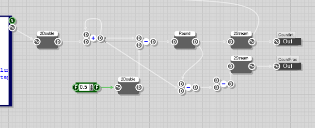

But it works out perfectly, see:
CountInt = round(Input - 0.5)
Input is 2, that means CountInt = round(2 - 0.5) = 2
CountFrac is Input - CountInt, which is 2 - 2 = 0.
WavePlayer always reads (1.0-CountFrac) * sample[CountInt] + CountFrac * sample[CountInt+1]
(simple linear interpolation)
which in this example turns out to be:
(1.0 - 0.0) * sample[2] + 0.0 * sample[3] = sample[2]
which is exactly what it should be.
Now try with Input = 3 (odd number)
CountInt = round(3 - 0.5) = 2
CountFrac = 3 - 2 = 1
(1.0 - 1.0) * sample[2] + 1.0 * sample[3] = sample[3]
works exactly like it's supposed to.
