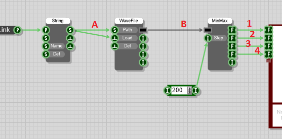

Well guys, I've spent all the afternoon/evening to read, traduce and understand the Spogg Trigger manual suggestion, and yeah, I've got few new things. But...
tulamide wrote:So let me point out: You may never rely on anything! Don't assume an order, in which events will be triggered. Don't try to force or prevent a redrawing. Don't try to do that 30 year old, static top to bottom executed code.
why did you said this? That's made me confused and out of the ride. I totally misunderstand your speak here. There is a "sort of order"! That's why the things works (even my example with Preset String).
Page 11, the author clearly says: "When the first 'no ticks' link gets a trigger, it has total control over the schematic until everything connected to that link has finished working – only then will the next link see the trigger."
This makes the sense for the Triggers. There is trigger order for chain. This means that its not possible that trigger out of this chain acts before the chain finish its works (inherit trigger included).
In this way, my example/image of asynch trigger from different place of schematic makes no sense.
Since the chain of the "master trigger" need to finish its works before a trigger from "another" place of the schematic act, it's is not possible that once trigger B starts (well, not really a trigger here; I mean the mem from schematic trigger Min/Max prim when I load it), trigger A run until 1/2/3/4 (which are in the chain of B) ends its works putting data to Ruby connector.

I don't think the outputs marked '1,2,3,4' should be considered separately. They are of the PRIM.
What happens after those outputs then depends on the circuit path from there.

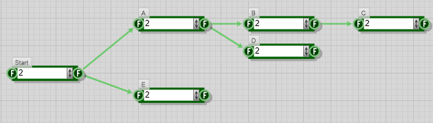

Not sure if I got correctly your words. With a more easy example:
here it's not possible that (when I change Float Start), Float E data get updated before all A/B/C/D Floats get updated. Can you confirm this? (and save my life :lol: )

Tronic wrote::|
Why that puzzled emoticon? :D
That's confirm my thoughts. So triggers have an order, run with some sequence logic, they are not all unrelated.
At this point, is it correct "exaggerate" and say that "triggers" runs individually? i.e. can't exist two triggers that run in parallel at the same fixed time/tick (even with two (or more) CPU core).
alright ... I'll take a stab at this. From my understanding/experience dealing with trigger ORDER [not so much TIMING, which I would say coding something THAT specific would be logically better handled/controlled in RUBY code] ...
From [START] -> trigger FIRST to A, then E [looking at the black marker coming off [START].
[A] triggers [B], then [D] ... then [C].
The UNKNOWN .... how FAST does the trigger pass from [START] to [FINISH].

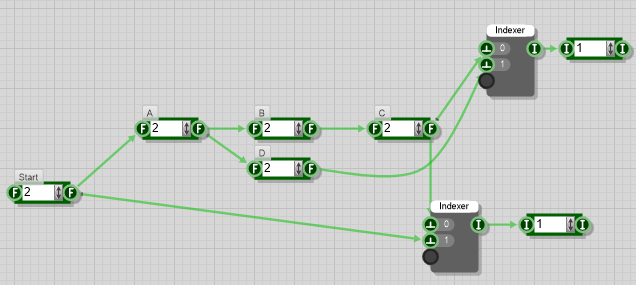

RJHollins wrote:From [START] -> trigger FIRST to A, then E [looking at the black marker coming off [START].
No man. Its not Start->A, START->E, A->B, A->D, B->C.
It's Start->A, A->B, B->C, A->D, Start->E. This remove the dubt I guess:
since I've removed Float E and link Start (tick 1) directly to the Indexer (which is still the last to be triggered).
