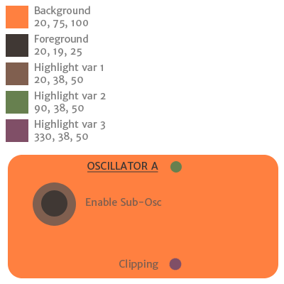

You should aim for 3 to 6 colors most of the time. People won't be attracted to GUIs with dozens of colors, especially if they are over-saturated. Which brings me to another example. While in my palette the dominant color is a dark one, and so the other colors were lighter. If I use nearly the same values (for example from background to foreground the brightness was increased by 60% from 25% to 40%), but for a light dominant color, I obviously have to decrease brightness and saturation. But does this still look good? Well, decide for yourself.
Let's imagine someone's preferred color would be a nasty orange. I know, who would ever prefer such an eye-hurting color? But still, let's just assume there would be one person in the whole wide world. How would the color palette look like if done similar to Sinner? Like so:
In this case the dominant color is also the lightest instead of the darkest, etc. Everything is reversed. And doesn't it look beautiful? Apart from the orange of course which is still burning my eyes...
