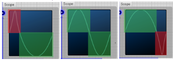

Maybe we just talked past another?
The lines enclosed in red are not sinusoidal waves (they are the "opposite", so to speak), the ones in green are.
Here is an example of a fully sinusoidal wave that is continuous on either side and in the center:
