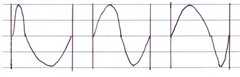

Guys!
I spent a couple of hours on this last night, also playing around with self-phase modulation (feedback) and also using a second synchronised oscillator for the modulation source with various waveforms. I got similar results to Martin but not what I understood tulamide was asking for.
Like nix I thought he was after something like zero-crossing modulation as per my very poor sketch below.
Martin's technique is found in the DX7 and my QX7 whereby feedback around 1 oscillator and env creates a wide range of harmonic variations. Maybe tulamide could clarify what he wanted...?
- zero crossing modulation.png (23.31 KiB) Viewed 28025 times
Re: Irregular Sine Waves
Hey Spogg,
you are absolutely right. What you sketched is what I oringinally looked for. And I would love to see that realized. But I also have fun with Martin's demo. So, if my original thoughts can't be realized, at least some alternative is available.
My thoughts began with the simple imagination of a sine wave, whose "center point" is moved away from the center. I can replicate this behaviour with my spline class for Ruby. But I couldn't find a formula for this. (See attached fsm)
You can't just reduce/increase the radius of the two half-circles, since the whole line from the top of the first half to the bottom of the second half is influenced.
So, yes, you are right. That's what I wondered about.
One thing I tried last night was modulating the frequency (not phase) with a separate synchronised variable pulse width square wave oscillator.
I figured that by varying the mark/space ratio I could achieve the desired result. This kinda worked BUT the overall period changed with the m/s ratio. This is because the frequency control spent more/less time high than low as the m/s ratio deviated from 50/50. It might be possible to create some compensation for this but it would not be elegant.
Unless someone knows better...
I thought this was going to be easy when I read the OP but it ain't!
