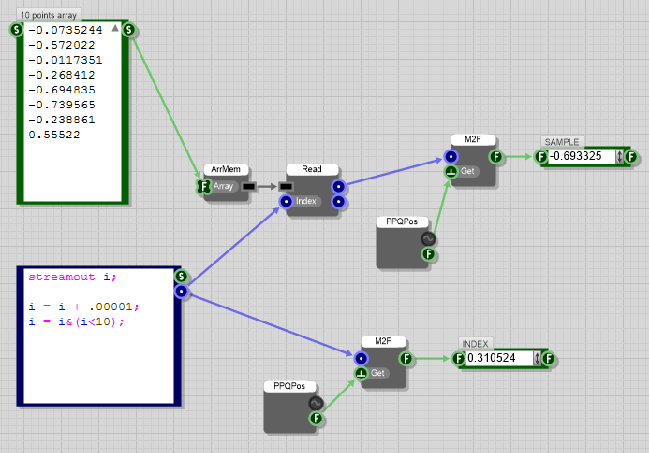

martinvicanek wrote:Todays hardware performance is amazing, isnt it? ;)
Hahah, I don't mean this. I mean that such code:
i = i + speed;
i = i&(i<samples);
processed at different clock (44100hz as you noticed) instead of 48Khz, makes huge differents if I use it for read sample from a Read module (as you suggested). Because it increase the speed of the whole process.
It is not a simple "for statement" that try to iterate in the slower time (more CPU you have, more faster it will be). Its a "for" that must iterate in a fixed time (i.e. sync). Am I right?

Anyway I think I'm making some other mistakes:
Without rely on Graph (I removed it; could be delayed as suggested), every time an integer in INDEX module is outputted, I should immediatly see the current sample of that index changing in the other SAMPLE module.
Instead they are way (waayy) to async. What am I missing dudes? Its somethings like 3/4 seconds delayed. Too heavy...
schematic.fsm
(718 Bytes) Downloaded 974 times
can't figure it out! :(
I guess that:
when i==0 output => -0.693325
when i==1 output => 0.755871
and so on. Instead it "change" around i=1.78 for example, and the first step is quicker than the others (i=1 happens quickly).

hmm-
can I get the whole LFO schematic?
Do you need to use ppq?
ps- when you use .00001 as the counter iter,
it takes very long to count to 1, which is where it will register an integer step in the wave read

Hey again Nowhk,
I saw your post at Fruity, so I learnt more about the ppq hack.
Here is the counter I have modified->
schematic_integer.fsm
(1.15 KiB) Downloaded 1025 times
So the string array and the counter read the same.
Does that help?
http://imageshack.com/a/img633/1214/qJgkVp.png

nix wrote:Hey again Nowhk,
Does that help?
Uhm, I don't understand your schematic: it's identical to mine! And in fact using "i + .00001" I've the same problem.
billv wrote:This might help.
Check the blue section in this modulator. (It's an old 'myco' circuit from way back.)
schematic_bv.fsm
Uhm, not really :o The method is the same (stream->read mem->ppq tick->out), but the problem is that the index/output of the stream seems not aligned with the DSP code. I can see the values change, but not at the correct integer time/index :cry:
