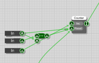

The general Plan is for a ruby module with in's/out's like these.
I don't mind spending the next 6 months, chipping away at this..... all good...great fun
