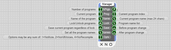

@CoreStylerz:
I disabled all Modules in my standalone effect because i had dropouts while changing presets...
Only 2 find the Preset Manager is the bad ass...
No doc or Changelist Info about the new Options Input in the Preset Manger: 1=NoMute, 2=NoKillVoices, 4=NoRecompile
1=NoMute did it 4 me
cheers,
Walter
P.S.: Just found out that my Preset Manager Modul in my Toolbox missed the Int 7(default?) in the Options Input...
Man! - where did you get this info from???Make sure that preset manager is not set to recompile, kill voices.
cheers,
Walter
- Preset Manager Options FAQ.png (28.21 KiB) Viewed 16009 times
