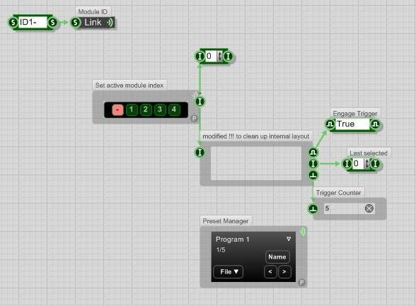

Struggling to pull this idea together ... trying to build an ENGAGE button logic.
There is a 'Radio' button selector that gives the user 5 selections to choose from.
Clicking through the radio indexes a 'preview' of the objects available for THAT selection. BUT ... they are NOT yet active [important].
Tied to the radio buttons is an ENGAGE button that activates that selection. A 'feature' of the ENGAGE button ... it will disappear after selection, and only reappear when a different radio button is hit. If the user goes back to the previously chosen button ... the ENGAGE button disappears [because it is active already].
The basics of this is working. The schematic 'logic' might be a bit goofy ... but it mirrors what I'm needing to do.
The problem:
When recalling settings via the PreSet Manager.
The radio buttons set to the stored value, but the ENGAGE button logic is not correct. I've played with this so much I can't see to a solution :roll: Maybe someone would please look ...
Maybe the current design logic is flawed ... I don't know, as I've gone in circles with this.
Here's a screen shot:
and the schematic
Engage with Preset recall-1.fsm
(16.63 KiB) Downloaded 992 times
please help save me from myself :lol: Even wonder if a RUBY solution would be easier :|

1.When I click engage, it sends trigger and the engage boolean is set true.
2. when I click different option, engage boolean is set false and trigger output is not send.
3. when I click back the option that was engaged, engage boolean is set true again and trigger is send.
Is that how it should be? shouldn't the trigger be send only when new engage is clicked?

Here... this one seems to work correctly. I have build it anew. Much smaller and simpler I think. Changed the Engage button from toggle to click trigger too. Feel free to ask any questions.

Doing some early testing. The 'engaged' selection seems to be working fine [picking a different index activates the engage display, while returning to to original index value clears it]. That makes good GUI sense ;)
I'm seeing a problem cycling through the Preset Manager. The indexes are recalled correctly, however, the ENGAGE button displays [?!?] :|
Selecting a preset ... if I change the radio selection and THEN go to the 'saved' index, THEN the ENGAGE button disappears. [as it should do].
The PM does not trigger the engage button display logic correctly.
I need to study the example you've posted to better understand the circuit.

Fixed... added "after preset change" trigger that is send from preset manager, to update stuff.
