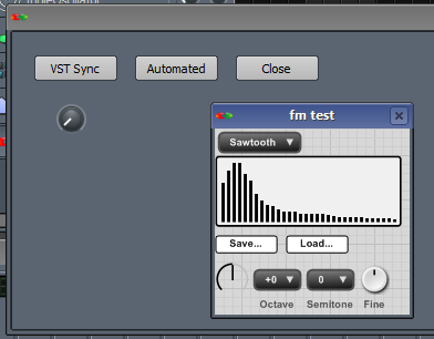

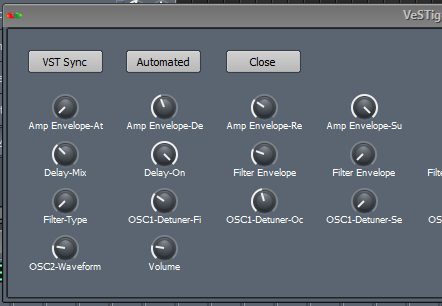

I'm working on a VSTi in FlowStone, but there is one small bug that is holding production back. My host program (LMMS) has a separate window for knobs whose values can be automated, but my it has no knobs for my VSTi. However, the example synth for FlowStone does have these knobs and I can't see the difference that allows these values to be recognized.
Does anybody know how I would allow my host to see these knobs as automatable values?
I posted some pictures to aid my terrible description of the problem, to give an idea of exactly what I'm talking about.
Thanks for your time and effort.
- This is a test synth I made, with NO knobs being generated in the host.
- KnobsNotWorking.PNG (18.82 KiB) Viewed 22153 times
- This is the FS Example Synth, with all the knob values showing up in the host GUI.
- KnobsWorking.PNG (21.31 KiB) Viewed 22153 times

hello cubician and welcome to the forum
to make an parameter automatable you need to insert a presetparameter primitive, name the parameter and set auto to true (if you want the parameter to be saved in presets too also set preset to true)
just go inside the stock knob and see the preset module, you will see that auto and preset is set to true..

Welcome to the forum, cubician.
You may also need a 'preset manager' module. This is the central controller for presets and automation - you only need one of these in your synth, and it will do the business for as many controls as you like.
Just drop it into your schematic anywhere that's convenient - so long as you have used the standard knobs and switches from the toolbox, everything else you need is already inside the controls. By default, the manager will also appear on the front panel of your synth - but if you prefer to use the host for loading/saving presets you can select the module and click the little eye icon at the bottom to hide it.
You then need to make sure that all your controls are given names - and the names must be unique, as the host will get confused if you have two the same. To do this, just click the little 'P' at the bottom right of the knob modules - they will then show you the 'properties' panel where you can set the name, and turn automation on and off for each control.
If you do want the manager on your plugin's front panel for preset loading, the properties panel of the preset manager will let you decide how many presets you want to store. If you make some presets while you're inside Flowstone, they will become the default presets when you first load the plugin.
Once you get the hang of it, there are other modules for adding presets and automation to your own custom controls - as Nubeat says, just take a peek inside one of the toolbox controls to get an idea how it is done.
Happy Flowstoning,
Trog.
Happy Flowstoning,
Trog.
