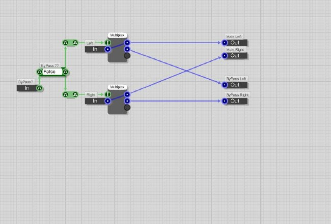

OK ... just to keep this as simple/direct, here is a basic schematic that routes audio to 2 destinations based on the status of a switch:
Simple router-1.jpg (58.02 KiB) Viewed 21122 times
This design uses the MULTIPLEX Prim as the base.
I have others that use RUBY for streaming, and another using GREEN ... each of these can do the job, some better than others .... but they all crash Reaper on close :|

I recreated your multiplexer schematic and tried it with Reaper 4.55 (!). No issues. For convenience I attached the version I built for use in Reaper. I suspect it has nothing to do with Flowstone or Reaper, but bidule.
bypass.fsm
(4.18 KiB) Downloaded 918 times

might the problem be due to the OPEN connection to the OUTPUT ? It's basically becomes an output with nothing there ... could these cause an issue ?
To test for something like this, could I tie in a 'default' value [like '0'] to the 2 open outputs ? How would this be done ?
Remember ... loading this all in ... the entire fx chain works. I can save off a session and reload ... still good. It crashes Reaper only when closing the session.

Empty output = 0. But if you are not sure - put some -180dB noise to all outs. Since FS items like filters (3 months without flowstone and I'm starting to forget the names of descriptors...) don't like to process 0's, maybe the same happens on something connected after your plugin?
Option 2: instead of using multiplexers - you can create active ones using multipliers (thus - no recompiling within schematic).
