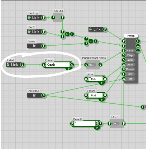

A while back I set my knobs up so that setting the knob label in the properties would also name the (preset) parameter, as a convenience thing. The idea was that it would save me from having to fill in both fields every time I changed or added a knob, but I could set the preset name independently if I needed to.
More recently, I found out that the second case wasn't happening. The problem seems to be that every time the module properties window is opened, it pulls values right through, regardless of whether triggers are being blocked or whatever. Take a look at the screenshot to see what I mean:
I've tried all manner of things in between the "Preset" string and the value coming into it from "Label" to control whether or not the string value is being set to the "Label" value, but nothing I've tried works because it always pulls the value through whenever the properties panel is opened again. And note that the "Preset" string needs to be changed directly so that it displays correctly in the properties window, so I can't for instance just put a last switch after "Preset" and "Label" (I'm not sure that would work anyways given how it seemingly ignores trigger flow).
I've already spent too long puzzling over this silly issue, but if anyone else has any ideas how to make this work as intended I would be grateful to hear them.

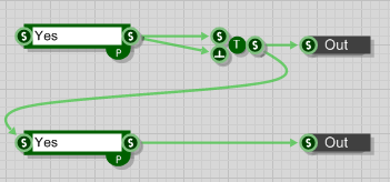

This alone is enough to demonstrate:
Properties Bug.PNG (5.48 KiB) Viewed 19357 times
Again, simply opening the properties panel causes the second string to be set to the first, and only within these projects.

MyCo wrote:in your "big" schematic, try that:
Connect a "Trigger Counter" parallel to the 2nd input... and then open/close the properties til the 2nd input changes. Now go back to the Trigger counter and look if it increased. Basically you'll see if there was a real trigger or if it just was a backward value re-read.
In case of the last, you could work around that with a "sample and hold" with both inputs connected to the first input. If it's a real trigger, there is no chance
It isn't a trigger. I realized this when I wired up output strings like you had and the value didn't propagate out to them. And I verified with the trigger counter just now as well.
I don't quite understand your suggestion though. Of course two strings wired to one input will combine them.
If you mean something like in this pic, I've tested it and it still happens.
Properties Bug 2.PNG (10.59 KiB) Viewed 19339 times
If it actually was a trigger I could just switch it with a trigger switch or something and my previous confused attempts to thwart this would not have been in vain!
