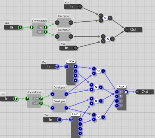

I was trying to use a Dry/Wet mix module after a down sampling effect, and i was shocked because the stream one i always use didn't work. The output gone crazy. i thought i try to unpack it to mono and it worked as it should!
This shouldn't happen right!? Whats going on? :lol:

My suspicion is that there might be something in the dezipper module that is not mono4 compatible.

streamin in;
streamin range;
streamout out;
in = in*range;
out = rndint(in) / range;
You are writing to an input... basically you're messing up memory here, so there has to be an unexpected result... :mrgreen:

MyCo wrote:You are writing to an input... basically you're messing up memory here, so there has to be an unexpected result... :mrgreen:
Oh man you know your stuff huh? 8-) i would have never guessed that one. This solved it:
streamin in;
streamin range;
streamout out;
float temp;
temp = in*range;
out = rndint(temp) / range;
