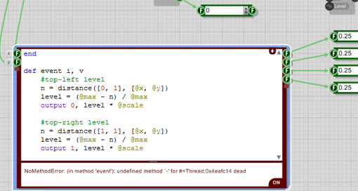

This looks potentially very useful for Lissajou stuff and more. Unfortunately I get an error in the Ruby Component, see below.
Ruby error in 4 channel xy controller.png (65.19 KiB) Viewed 16793 times
The hex code at the end of the error line changes with the x/y position on the 'joystick' but all the 4 float output values stay at 0.25.
I'm on the latest FS 3.08.1 and I wish I knew some Ruby to fix this because it looks great!

I got the same error. If you rename x by z (both input and code) it disappears. Ugly FS bug that is!

As Martin says, we just determined '@x' being the cause. It is not the automatically generated variable that belongs to the input named 'x', but seems to be overriden by something internal. It is a bug from my point of view, since this was never before an issue and only happens under 3.0.8.1 (3.0.8 also?)
Until this is fixed, avoid naming any input 'x'
EDIT: Also, if you wish to use the RubyEdit-Code without the x/y-pad, keep in mind that this was made for that special pad, which means, it will only work correctly, if the bottom/highest y refers to 0, and the top/lowest to 1. It has to be mentioned because most of Computer graphics work the other way round (top = 0, bottom = 1)
