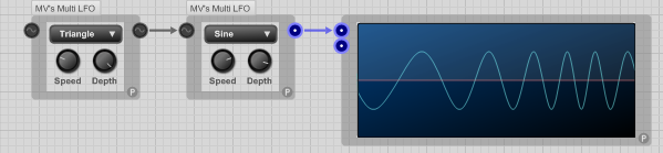

Hello, i have a theoretical question. How to create a dynamic change of frequency lfo, using lfo2.
http://rghost.ru/7PrFXKCgR/image.png

Here is a practical answer. ;)
ModulatedLFO.fsm
(31.5 KiB) Downloaded 926 times

This is the only way?

You can manipulate phase offsets as well.

i try use sin( pi*2 / ( 44100.0 / control) * count) control = pseudo lfo2
If i change in real-time parametr contol, sound comes from clicks. Hmm...
