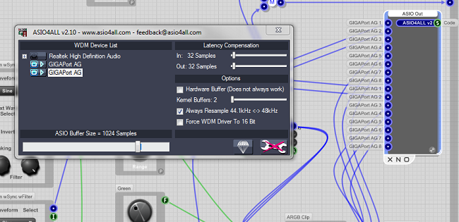

I wanted to add that ASIO4ALL shows all 16 outputs but does not work... i.e. while I can open the ASIO4ALL configuration dialog, Flowstone does not output ANY signal...?
It all seems to "work" but no output, no streaming data etc.
Not Working... but it looks like its working

Have you tried this Asio4All configuration with another software? Maybe it's not a FlowStone issue.
I guess DirectSound wouldn't work, because it only allows 1 device to be active at any time. I don't think FS could even work with multiple active audio devices, as they might have different properties (Sample rate, buffer size,sample types,...)

Just wanted to say the issue turned out to be crappy / bad ASIO drivers AND the fact that the driver treated both boards separately and so was just muxing (switching / alternating) the 16 (8 x 2) data outputs !
The noise and signal was AWFULL :shock: !
