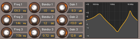

I'm also interessed in this kind of filters, if I can re-use in my plugin.
Would be nice have a sort of 3-Band EQ filter such as Kontakt:
with visual display. I can't see any "Peak filter" (Freq, Width and Gain) in FlowStone from the standard library. Is there?

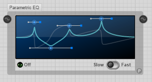

Re: Variable Bandwidth Bandpass Filter
this should be included in the audiopack or?
- eq.png (16.13 KiB) Viewed 25131 times
Yes of course, but try to move a band with mouse for example: steppy, it looks freeze, not smooth. Considering I need to fast automate it, will crash, or get a bad visual feedback (which is important to me get it smooth). That's why I've asked for somethings different. Or I could try to put my hands on it and do my bestNubeat7 wrote:this should be included in the audiopack or?
sadly there is no market for readymade solutions around here (lot of forum people where against it at the last try, because they would have to pay then
) anyway, look for martins optimized biquad filter pack, these you can control also with lfo's or other streambased sources
