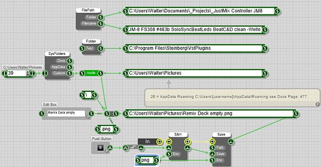

Re: Now with Win-7 64bit ... FS issues
Hi RJ,
here is what i know about it:
1. Have a look here for UAC: https://en.wikipedia.org/wiki/User_Account_Control
2.Progs now use C:\Users\[username]\AppData\Roaming\YourPathName for their ini's, logs or external tools...
(I use some AHK compilations in conjunction with my FS.exe)
=> System Folders: see Docs Page 477
3. Start programs elevated from a batch file: http://www.winability.com/elevate/
4. Hint: Shell Execute now has 'runas'... => see Docs Page 424
5. The Pro's can even embed Tools inside FS (with help from DWB
Cheers,
Walter
