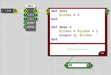

The schema is pretty simple:
every time I click with mouse on the work space, the counter increment itself: this means that draw function is called.
It is strange when working on the tools, since if I'm making graphic it messes with index/time line of processing.
That's normal? Can I avoid this? Thanks!

Re: Why mouse click invoke draw?
Here on the forums was a talk about it, if I remember correctly. You have to avoid sending to the output from within the draw method. Any output call lets Flowstone redraw the functional elements around the view (the circular inputs/outputs). For some reason, probably to take care the view itself stays intact, a draw call is also sent to Ruby.
Conclusion: Call the output method only from methods that are not connected to the draw method.
The standard method is to calculate any variable you need for drawing in event/mouseXYZ or a method called from there, and in draw you just draw to the view.
The multiple times redraw you see should only happen in the schematic (not on the frontpanel). Basically, FS forces a redraw for the green float box you've connected to the output, this redraw is sent to Ruby as well (maybe it shouldn't but there might be a reason for it)
