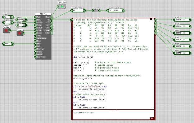

I am using the Com Port Module to read in byte (hex) data from a digitizing tablet (and 16 button cursor). been banging my head for too long on this and need a bit of Ruby help please.
I can read in the data but I know I am not getting the next values correctly. If I was using BASIC or C++ I would do this differently, but need to learn Ruby since it is in Flowstone my favorite programming system ever ! :D
Here is my code, The digitizer tablet data comes in as 6 bytes of hex data, one of which contains a 1 in the MSB position to sync off of... Normally I would keep reading the input value until I get a "sync" then grab the next 5 bytes (and of coarse the first byte) for a total of all 6 bytes. But I cannot seem to get this working without the ability to jump back to a "label" (like in BASIC or C) and repeat the test to see if I have "sync".
The next issue is getting the next bytes in order... storing them in an array, then decoding them (still to be done), then repeating this process to keep streaming the data in, in order to be able to track the digitizer cursor and then when a user presses one of 16 cursor keys, that data coordinate pair is saved... ruby in Flowstone seems to be a little different than some of the online tutorials especially with inputting and outputting data, at least for me...

Here is a snapshot of the code but it is not syncing or putting the values into the array properly ??? All of the output values are the same, and thus the event is not getting updated with the most current data value.
Thanks for any Ruby help please :?
Aron

I couldn't test my changes, but you can :mrgreen:
The logic should work, but there might be typos.

Moved and added a few things around to get rid of a method error (added @'s) but output still populates the same number value in all instances, like the triggering isn't happening. Its like it reads the same number 6 times... ?
I'm still at it - I feel dumb :?
Thanks for your help !
Aron

Hey aronb,
the @s are very important. They make the variables instance variables. Without it they are local variables, which means they will be initialized each time the event method is called - which is not what you want. So make sure that each and every variable that is not just used once, but should keep its value, is an instance variable!
EDIT: I missed another one. You bitwise and a number with a string (a is a string). Exchange the event code with this one:
def event (i,v)
	#convert input value to binary format "0b00000000"
	a = get_data()
	# if MSB is 1 then sync
	if (a.to_i & 0b10000000) then
		@buffer = true
	end
	if @buffer == true
		@calcomp << a
	end
	if @calcomp.length == 6
		0..5.each do |n|
			output n, @calcomp[n]
		end
		@buffer = false
		@calcomp.clear
	end
end
