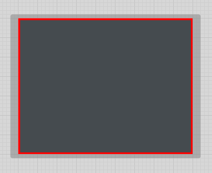

I've tried this suggestion: http://www.dsprobotics.com/support/view ... f=2&t=1074
but when I render the plug, the border bottom seems incorrect anyway:
def init
	@borderWidth = 0.4
end
def draw i,v
	# Background
	rc = [@borderWidth/2,@borderWidth/2,v.width-@borderWidth,v.height-@borderWidth]
	brushBackground = Brush.new Color.new(69,75,79)
	v.drawRectangle brushBackground,rc
	# Border
	pb = Pen.new Color.new(255,0,0),@borderWidth
	v.drawRoundRect pb,rc,0
end
def event i,v
	redraw 0
end
even thought right side is still tiny than left, even if less tiny than before...

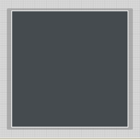

Oh dear, a year and a half late, but anyway, here's a screenshot from the world of v.3.0.0
I don't see a problem here, could the later versions be the cause ?
ROXY
Better late than never, does this help anyone ?

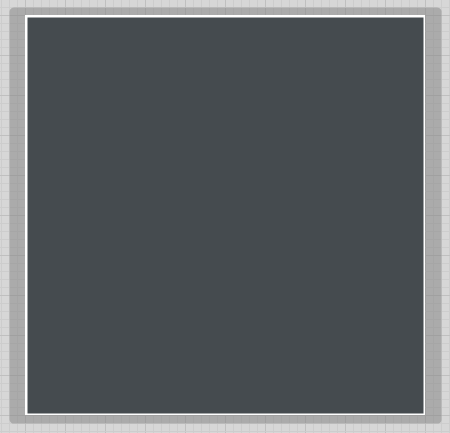

However, the problem happens the same. My grid is 1. I've set borderWidth 0.5 (which is a multiple of 0.125):
def init
	@borderWidth = 0.5
end
def draw i,v
	# Background
	# Border
end
def event i,v
	redraw 0
end
but I see the same. Or better: inside the schematic "maybe" it's a bit better (even if not precise at 100%; border top is slightly bigger than bottom):

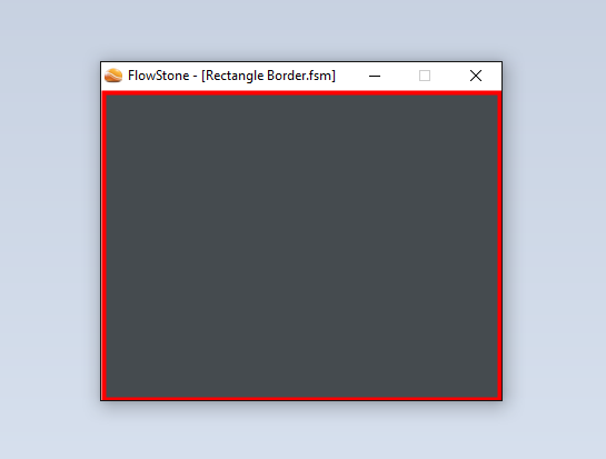

When I switch to Focus Mode (i.e. the result when I'll render the plugin) the difference is even more noticeable:
Do you see the same?
