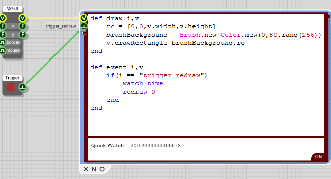

Hi all guys! I hope you can help me again ;)
I don't understand why I'm not able to call a redrawing of my View clicking on the Trigger button:
this should be pretty easy. Every Trigger click, a new Background color (notice the rand() function). But instead, only time in the "watch" zone change.
trigger redraw 0.fsm
(441 Bytes) Downloaded 934 times
Re: One (more) question about draw/redraw
Post by tulamide »
It does redraw the view. You just need to go to the toplevel to see it. It's better if you have the trigger button one layer higher, so you can observe it better, like here:
trigger redraw 0 [tula].fsm
(456 Bytes) Downloaded 892 times

I see. Thanks! My problem seems that I can't "prevent" redraw:
def init
	@doRedraw = false
end
def draw i,v
	if(!@doRedraw)
		return
	end
	rc = [0,0,v.width,v.height]
	brushBackground = Brush.new Color.new(0,80,rand(256))
	v.drawRectangle brushBackground,rc
end
def event i,v
	if(i == "trigger_redraw")
		@doRedraw = true
		redraw 0
		@doRedraw = false
	end
end
I'd like to "draw" only when I got a trigger (or an array Ruby input, for example) as input, not every time FlowStone invoke a general "redraw". Waste of resources for a controlled Area...
For example here, I'd like to change color every time I click on the Trigger button, not when I click on FlowStone workarea (that will invoke redraw inside Ruby).
trigger redraw 0_when_I_want.fsm
(494 Bytes) Downloaded 895 times
Post by tulamide »
The draw method is not intended to be used for any programming/claculations/etc. It is just for drawing. The view just needs to be redrawn, when Flowstone demands it, else it would give strange results (for example when moving another view partly over the first one, then move it back. The first one would now be partly non-existent because of the missing redraw.
So, do your calculations in a seperate method, not in the draw method. For example, you could randomize the blue value in the event method (using instance variables), just before calling redraw. The result is the same: Color only changes on trigger, not on internal redraw.
