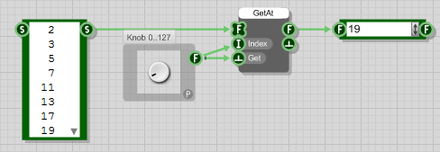

Like this?
- prmes.fsm
- (7.42 KiB) Downloaded 884 times

Hello Martin ....
That's exactly it
That was the method [GetAt] I was just testing before checking back in. It seemed to scroll through the list smoothly.
Prior to that, I had started testing a RUBY example using CASE statements. That worked, but would be a lot of typing for this current project
It's still going to be a lot ... I've 8 knobs that each hold 12 unique configurations.
Thanks for confirming this approach BEFORE I got to deep into it.
As always .... THANKS
