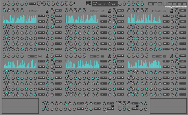

i attach a screenshot of my synth.
tracking the mouse for all those knobs is not a good idea as i figured out.
the most important problem is that the gui of the synth freezes when i move the mouse.
i guess i have to find another way of explaining how the synth works.

yes i did and things are slightly better but the synth is already using too much cpu
Re: knob tooltips
The synth looks amazing! It reminds me of some of the stuff I've made. But it's not orange.aombk wrote:yes i did and things are slightly better but the synth is already using too much cpu
Even if it uses most of my CPU I'd love to have a go with it. You can always render and freeze tracks in the DAW, so as long as it actually works while recording with one instance, I don't think it matters too much. Hey, I think I can hear tulamide...
