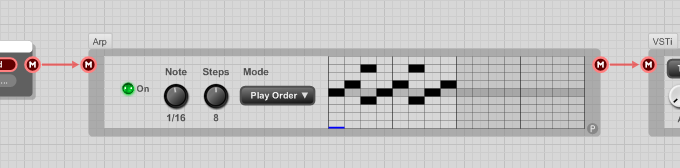

Here's an example we've been working on for an arpeggiator module.
To stay accurate all the timing critical stuff needs to be kept within a Ruby section. So that's inside a Ruby component or passed via Ruby Value or MIDI connectors. As soon as you convert back into triggered data you'll lose accuracy.

Thanks! That is nice to know because i thought this would be possible. Well then i have to get up my ruby skillssupport wrote:To stay accurate all the timing critical stuff needs to be kept within a Ruby section. So that's inside a Ruby component or passed via Ruby Value or MIDI connectors. As soon as you convert back into triggered data you'll lose accuracy.

edit:PS- Wow support! Thanks a million for the arp module.
I love it- very useful. I'll try learn some Ruby stripping the non-essentials out,
functioning as a clock
