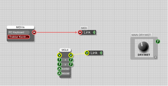

Hey all,
I have been playing around with TekToog's midi knobs (http://synthmaker.co.uk/forum/viewtopic.php?f=7&t=10207) and I have a problem :(
So I just have ONE knob in a vst that is linked to a midi in primitive
When I right-click and learn, move a pot on my traktorX1, it links. . . . yay, woohoo! :P But wait, it only works in FS???? :evil:
As soon as I export as VST and load into FLStudio( only used for testing ) I do the same, right-click . . . ect.
But now it doesnt link to my knob??? I can see the midi in is going mad in FL when I move the pot, So it is receiving midi from my X1 but just not in my VST. I can work around this in FL by linking my controller to the knob via the left pane\Edit Effects Section (dunno if anyone knows what I mean)
The point is right-click-to-learn works in FS but not in VST???
Anyone know why this might be?
Im probably missing something simple but I AM STUMPED :|
Someone with more experience please reply!
EDIT: Maybe its better to make my own midi learn-able knob????

Time to upload your schematic I think - there are many things that can be ruled out (or spotted) in just a few minutes if we have the file to play with.
